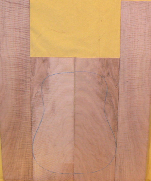

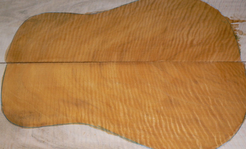

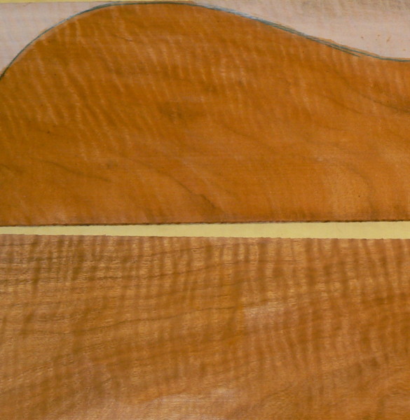

Just as promised. Here are some images of Marri (also called Red Gum). Marri weighs in dry at about 850kg/cubic metre, bends well and produces a good finish. The tonal qualities of Marri are still being ascertained. One luthier has been referred to in another post indicating that Marri has merit. All I can say is that it has worked well in Ross Coole's Resonator. A lot of Marri has gum veins so finding boards that are clean and have some figure requires patience. The back set that I have posted is back sawn however a quarter sawn set would be preferable being more stable when applying a finish. From experience bendng sides can be achieved without any added moisture. A hot dry bend in a Fox bender type jig works well.
The sanded set without shellac.
A comparison between side and back pieces that have been wiped with shellac.
The back set with some shellac.

Kim I have found that filling the gum veins with epoxy works quite well and can be very attractive. I wouldn't discount high figure boards with gum veins.

Very nice set of Marri Tim, I am with Bob, I have seen a lot of furniture made with Marri where the gum lines are presented very affectively as a feature.
